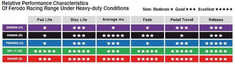

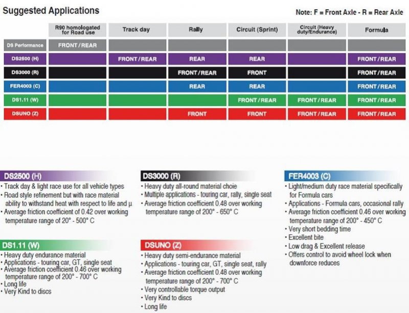

Qui aurait eu l'occasion de tester des Ferodo ds 1 . 11? voir les ds uno. Merci :thumbup:
si je m'amuse a tout comparer :P

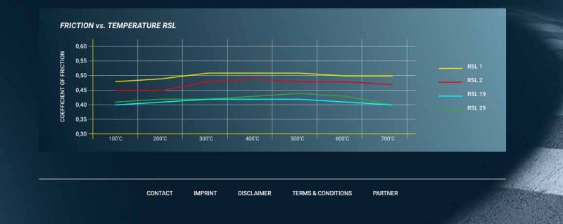

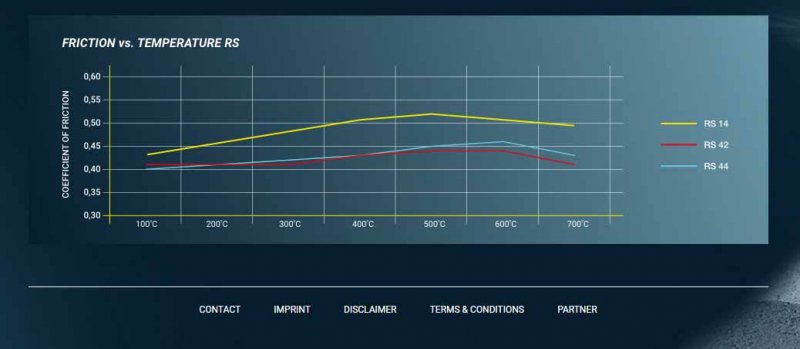

en comparaison les pagid deux dispos rs29 No. 8084 et rsl1

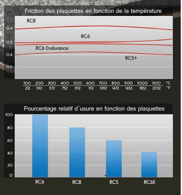

CL
RC5+ - average friction coefficient µ= 0,4. The newest compound in our range, the RC5+, was developed for light weight vehicles or racing in low grip conditions (street tires, gravel, mud, snow, water, etc.). An excellent track day compound, it offers moderate friction levels, low noise, is easy on OEM discs, and has excellent cold stopping power. Additionally, it can be used on the rear axle of vehicles to change the brake bias where standard bias adjustment is not possible.
RC6 - average friction coefficient µ= 0,4. Our original compound, RC6 was designed to apply to a wide range of motorsports, from rally to circuit. It has a high and very flat friction level and can be used successfully in almost every type of race car. Low compressibility provides a stiff pedal which greatly increases feedback and allows for easier modulation. It can also be used in the front or rear axle combined with the RC8 or RC5 to adjust bias.
RC6E - average friction coefficient: µ=0,46. New in 2008, the RC6 Endurance was designed to offer very low pad and disc wear rates without sacrificing friction levels. Need pads to last 6, 12 or even 24, hours. Look no further than the RC6E. The RC6E boasts the same easy bed-in and stable friction levels as all other CL Brakes compounds.
RC8 - average friction compound: µ=0,6. Developed in 2006, the RC8 compound boasts CL Brakes highest friction level and is used in top-tier motorsports such as WRC, WTCC, NASCAR, ZA V8, AWD GrpN, etc. Extremely high friction levels allow shorter stopping distances and the flat torque curve provides excellent modulation to prevent wheel lockup.
RC8R - average friction compound: µ=0,6. Using the same friction material as our standard RC8, we have grooved the backing plate to reduce the contact area with the piston and provide a radiator effect. This patented shape was created to reduce heat transfer through the piston and into the brake fluid.

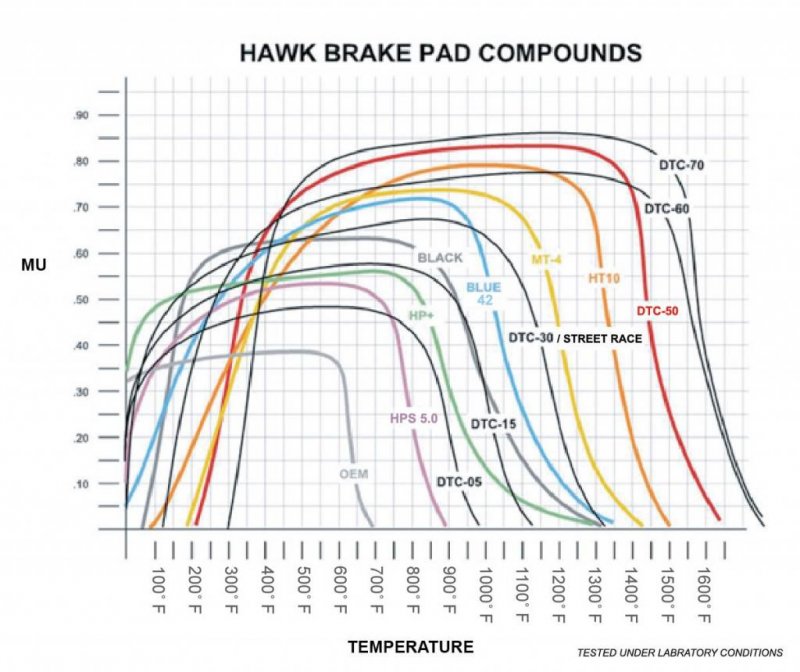

hawk

Un ami en ds uno sur sa s3 300cv est satisfait pour usage sportif sur route, mais au Nurb, ca fumait sec !

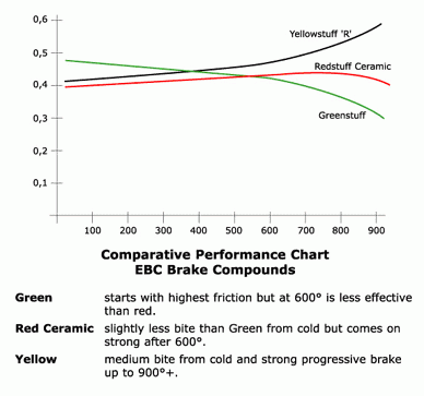

j'ai trouvé ces courbes sur un forum corvette . et je ne sais pas quelle choit faire entre ds uno ou 1.11 pour de la montagne avec un touché qui rende moins "spongieux" à la pression.

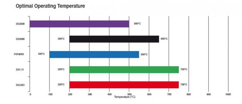

plus qu'a choisir les plaquettes et leur coef de friction en fonction de leur plage d'utilisation (T°C/Friction) par rapport à la température au niveau des disques/étriers. En pensant ne pas trop déséquilibrer AV/ AR avec les coef de friction j'opte pour des pagid à lavant / ferrodo ar.
